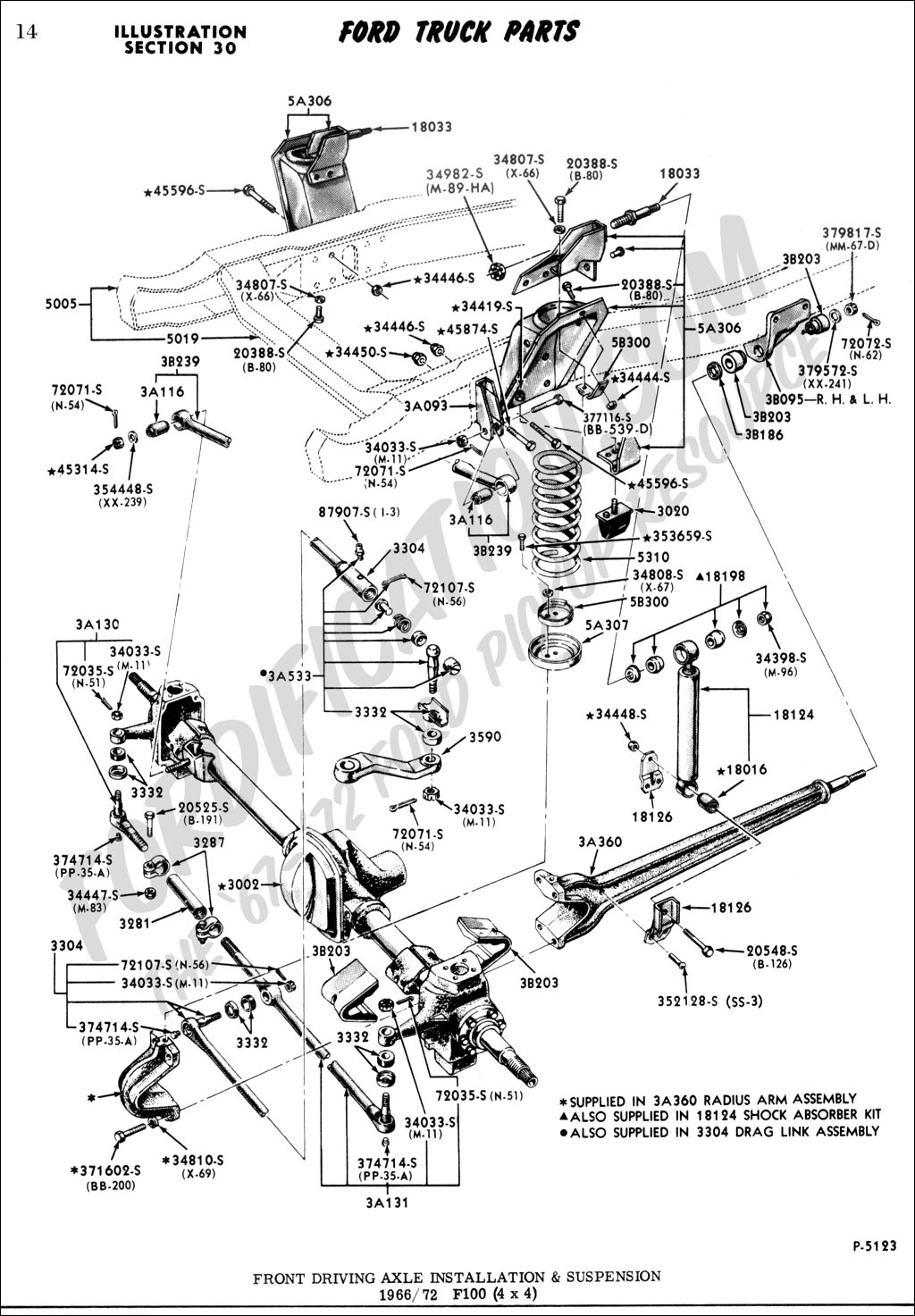

this looks like what you have. i think it is the same as i have on mine. http://www.fordification.com/tech/image ... ront06.jpg
i think the steering box should have a tag on top of it under one of the bolts. my pitman arm doesnt look like that. mine is almost completely straight. but it does have a slight down angle to it. my box is also set forward a little more. and my pitman arm points backwards.

Thanks Fordman. ive seen the one you linked before. it has a different end on the drag link that attaches to the pitman arm. unfortunately the ps gear has no tag.
