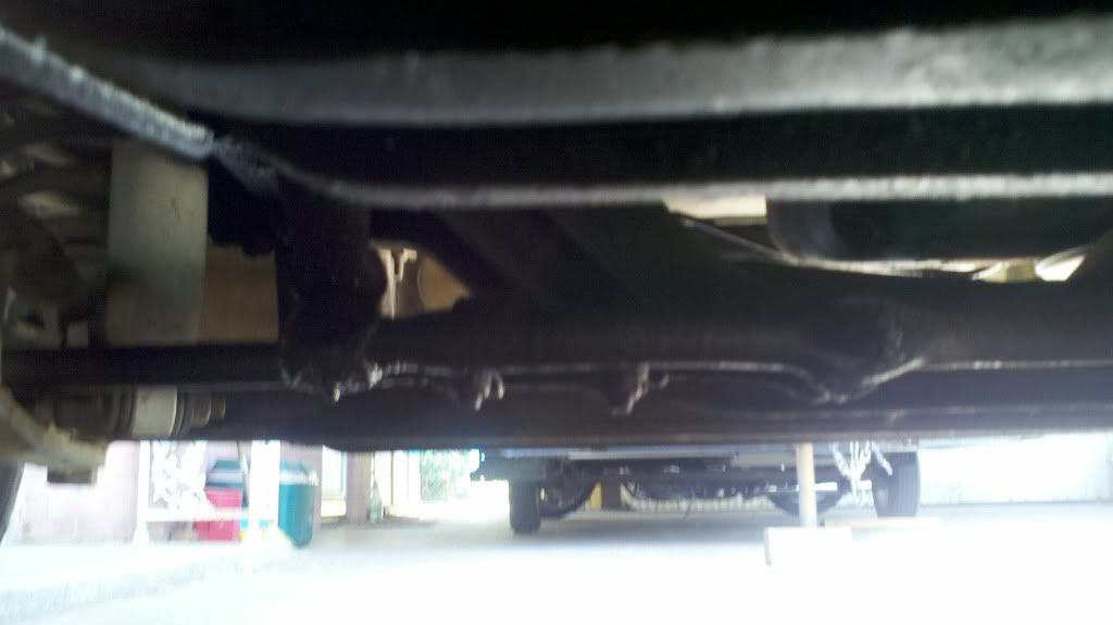

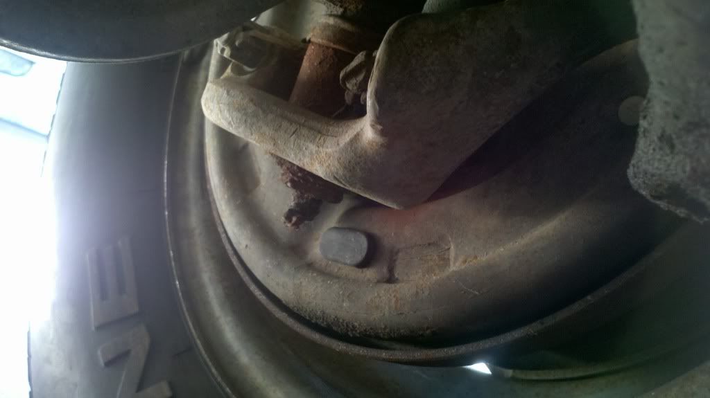

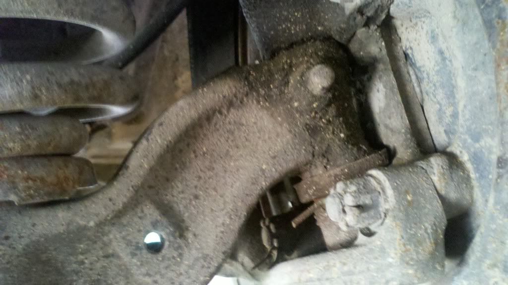

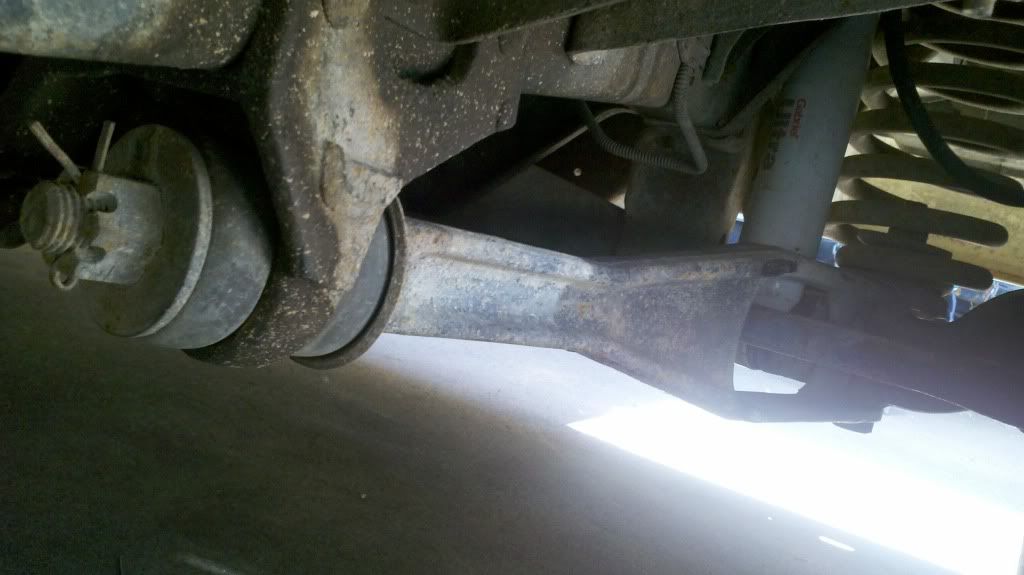

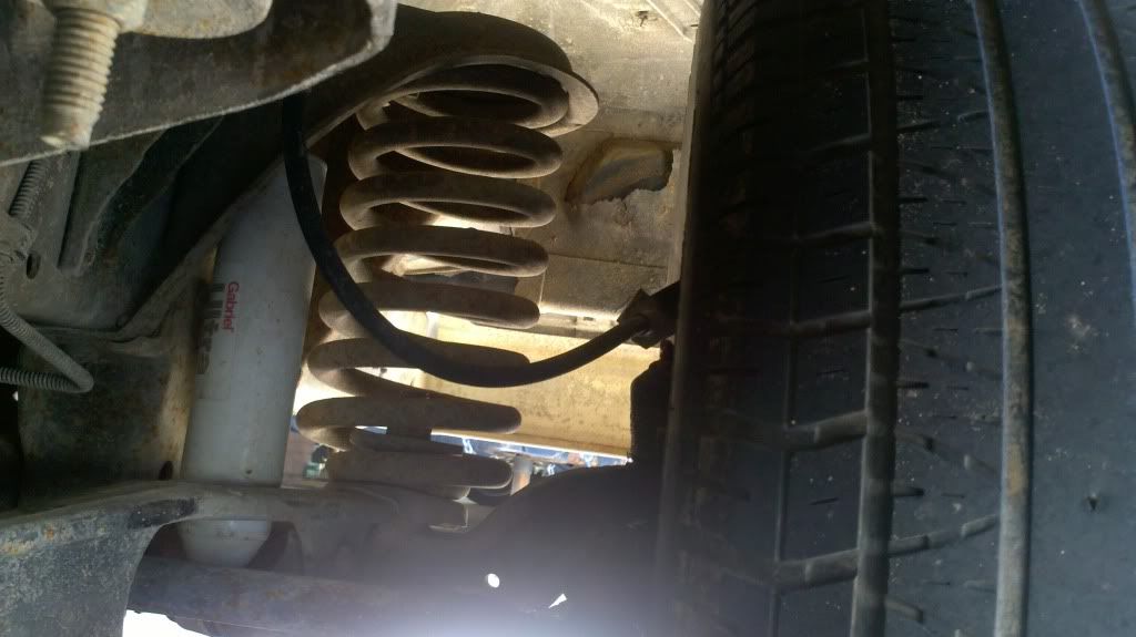

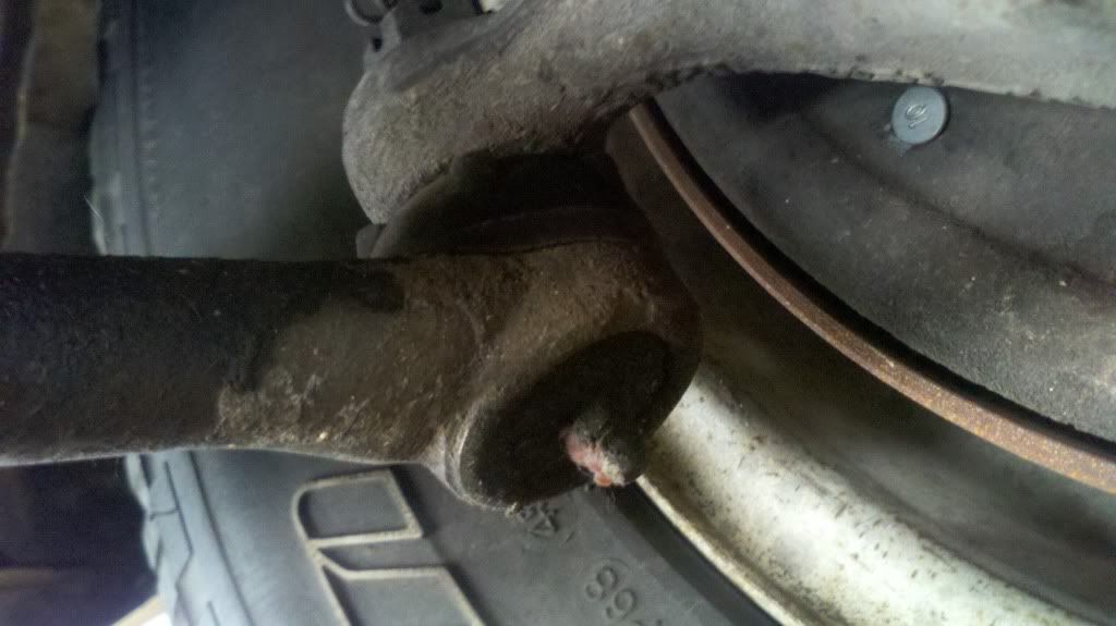

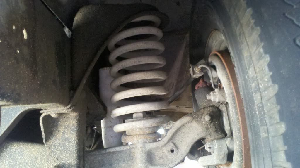

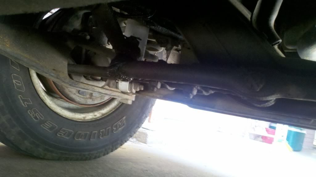

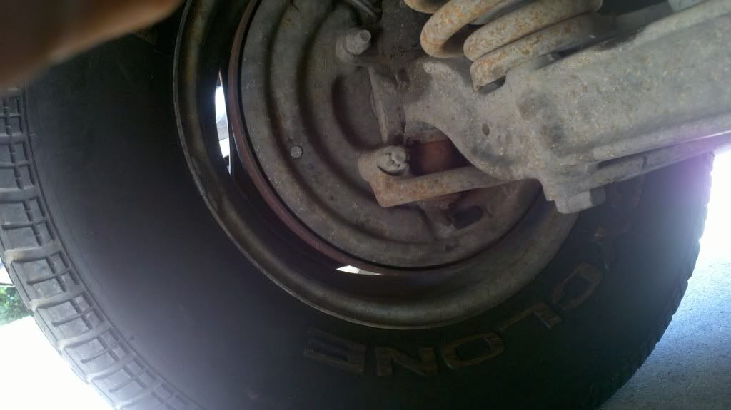

Ok finally I got some photos of my king pins and such would have got it sooner but I have been busy here the photos
Thats pretty much the under side of my truck hopefully that can give you guys a better idea of what is going on.

your suspension is worn out. Looks like it's all original (hard to tell about the king pins but that last pic looks like it is leaning a bit more than it should be) and as such I'm surprised it isn't worse. ;)
The components are relatively easy to replace, the king pins being the exception to that.
It also looks like you are missing your steering stops in the i-beams (the hole in the beam in that last pic)
Paul

I guess I need a parts list then but yeah like I said the last owners didn't do any matince to this truck.
