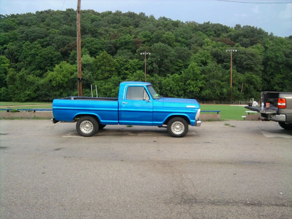

- Posts: 1144
- Joined: Thu Jul 08, 2010 5:18 pm
- Location: St Louis mo
Re: CRAGER S/S
235/60/15 on front
275/60/15 on rear
15X8 wheels all around
[/img]
275/60/15 on rear
