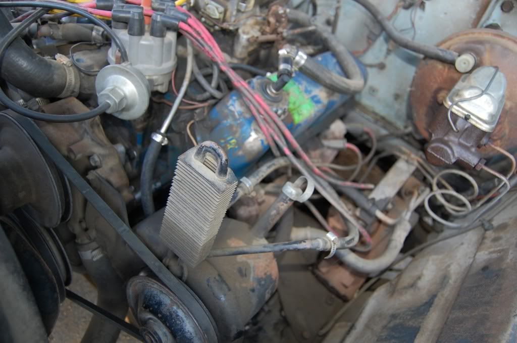

here is one io stole from someone else on the site.

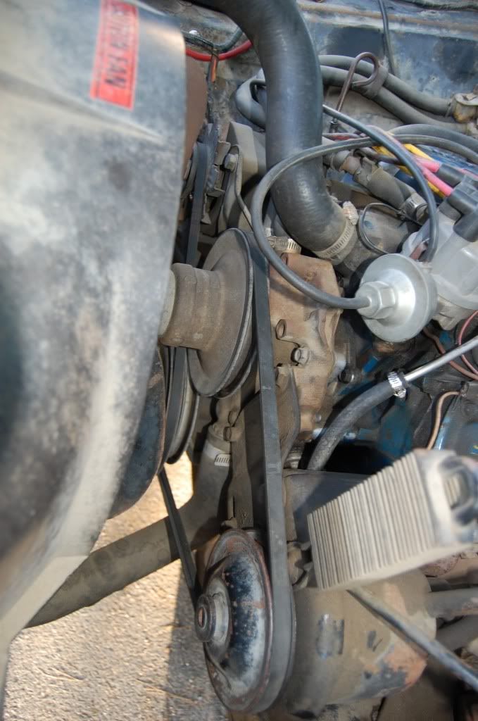

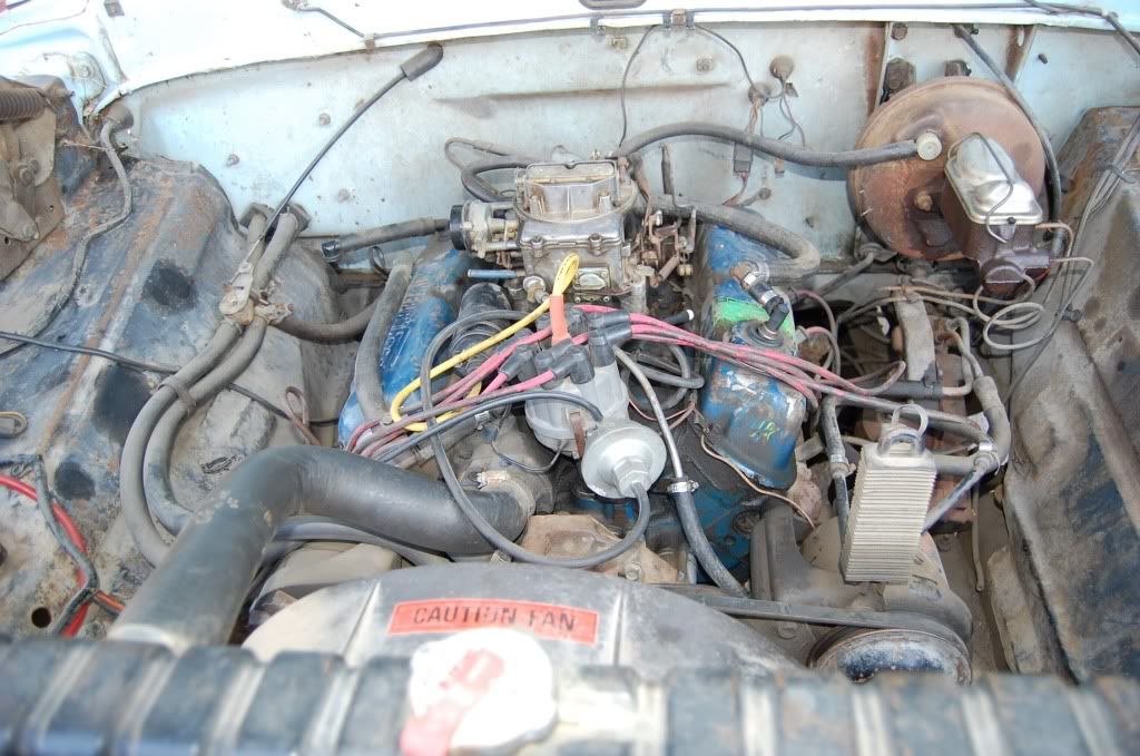

Here's a few from my truck, took them the other day...forgot I had them on ym photobucket. Lol.
Double shifts are evil....I hate work somedays...anyways hope they help..

Sparkz thanks man, between what you and Fordman posted i should be able to figure it out! :thup:

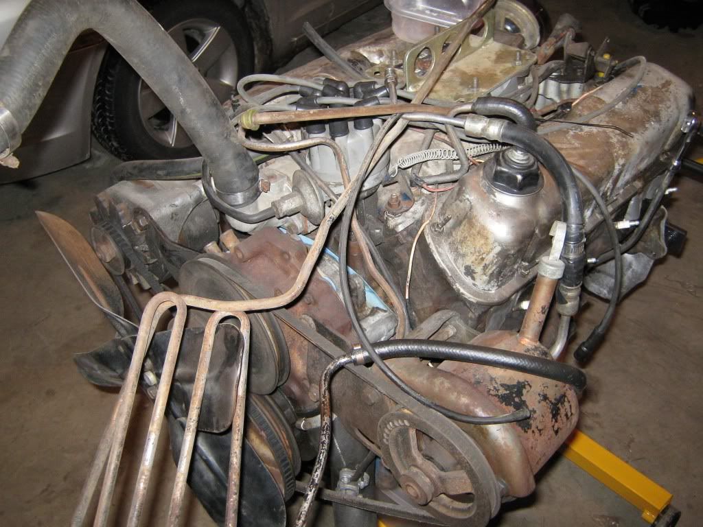

i am posting this picture of a 302 pump from 1978 as a reference so i can look at the bolt pattern and mount bosses.

ok measure the two holes on the bracket center to center then measure the bolt holes in the pump center to center. i have a 351m water pump on a engine the ps bracket mounting holes are about 3 5/16 apart. however the 351m pump bracket is similar looking to the Fe pump bracket. here is a picture of a Green 351m/400 bracket and water pump. and also a picture of a ford blue 351 c water pump. well that 351c pic is a bad picture. you cant see what we want to see.
what i am gettign at or thinking if the bracket is correct. is it possible that you have a the wrong pump? i dotn think so. but with my measurements and yours maybe something can be figured out. i do know that my 351w has the fe style bracket on it too. i dont have any pictures of it. if it isnt raining tomorrow i will get pics and measurements of it. i think i need to change the pump anyway.
