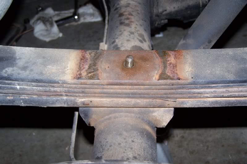

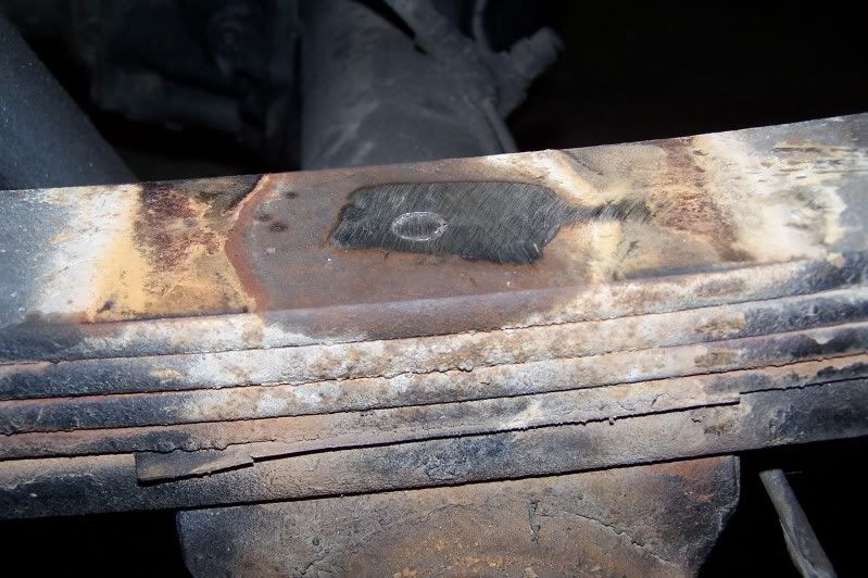

Pictures are worth 1000 words!! This is what broke.
The good one:
The broke one:
It broke off right at the bottom of the nut, so I cleaned it up with the grinder.

papabug71 wrote:im referring to the bolt that runs thru the leafs & bolts the leaf springs to the pad
The center bolt isn't bolted to the pad it just sits there.
Your's is just stuck, tap it loose with a hammer.

If it comes down to it, just buy a regular bolt and grind the hex head round. This bolt doesn't do much when everythings bolted up.
