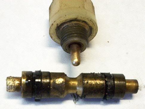

Back to plan A, I was able to get the piston out of the dist. block. Saving me bout 90 bucks.
Going to clean it up real good and reuse. Seems like I read somewhere to use Acatone to clean up the brass. Can anyone back this up?

OK found the article. NOT acetone but liquid ammonia!
1970 F100 Custom
Re: More brake help
where is this article? i think all there is inside of the vavles is a o ring.

Keep in mind that our differential valves use square edge O-rings, not round ones.
Also replacements must be compatible with brake fluid.

Thanks guys, I cleaned it up really good. I've decieded to use it as it is.
