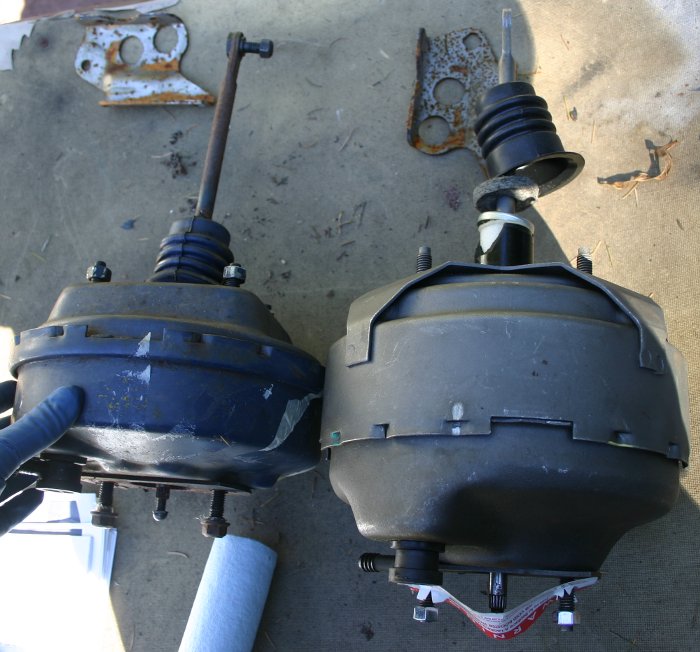

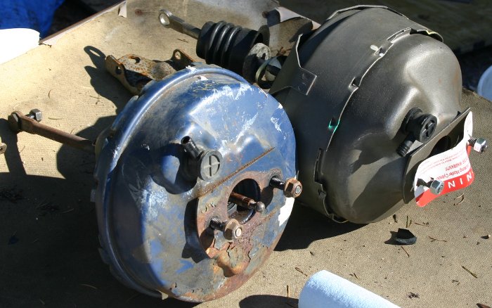

So the larger booster arrived and I got some side by side photos comparing it to my previous, smaller booster.
Fordman, you were right about the rod length being the same! Thanks.
And it looks like it'll be a direct bolt up. I'm pretty sure this is what my truck had on it when I bought it, and probably what it had from the factory. So I'll give the big booster a whirl!

Re: Which booster is right for my F250 w/disc (8,100lb GVW)?
that new booster looks very similar to the booster on my 68 f100. i have never seen a booster as small as the blue one on any truck i have ever parted out.

Post by robroy »
No wonder the brakes never worked very well! :)
