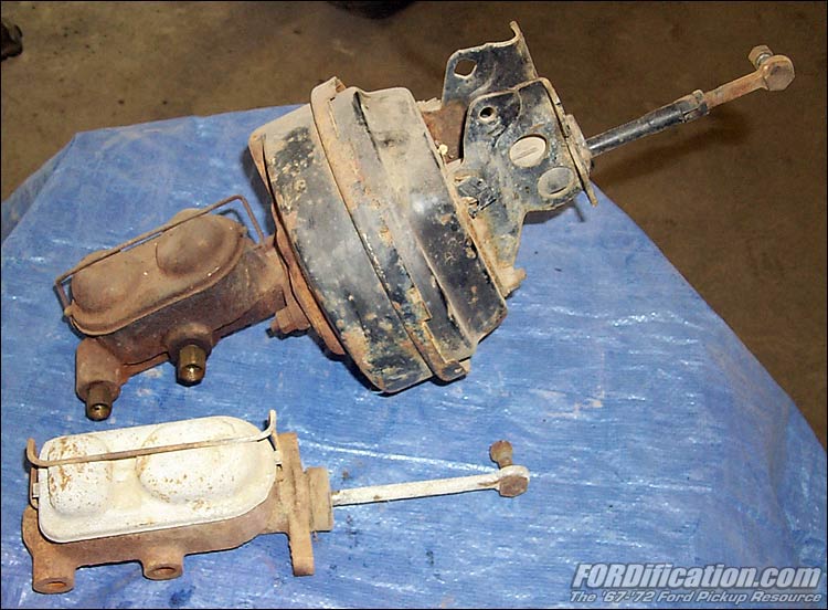

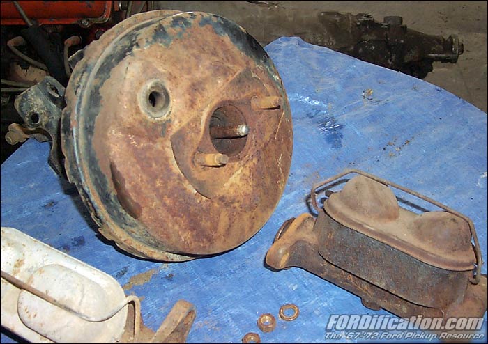

re: 1968 f 100 steering box
Swapping a power booster into a truck not equipped with power brakes has got to be one of the easiest swaps going. The following procedure pertains to installing the booster to give you four-wheel power drum brakes. If you opt for swapping in disc brakes, you'll also have to replace the master cylinder with one set up for a disc brake vehicle.
1) Disconnect the master cylinder pushrod from the brake pedal
2) Remove the two nuts holding the master cylinder to the firewall (do not remove the brake lines from the MC)
3) Carefully pull the MC away from the firewall and remove the pushrod that held into the end of the MC by a clip.
4) Insert the power booster into place between the MC and the firewall and bolt it into place.
5) Reconnect the MC to the power booster.
6) Reconnect the pushrod to the brake pedal.
7) Run a vacuum line from the booster to the intake manifold.
The power booster will have it's own MC-to-booster pushrod and booster-to-brake-pedal pushrod.
Here are some pictures:
PICTURE 1 - Here is a comparison shot of the manual brake MC (foreground) and the power brake setup (background).
PICTURE 2 - In this shot the MC is removed from the booster to show you the built-in MC pushrod
PICTURE 3 - Here's a closeup of the clip holding the manual brake MC pushrod.
As for the steering, you'll have to check to see where it's binding. Is it manual or power steering? If you're sure it's the box, I'd just replace it with either a good used one from a parts truck or even a new replacement. I just checked the AutoZone website and found that a new box is only about $150 and those come with a limited lifetime warranty.
