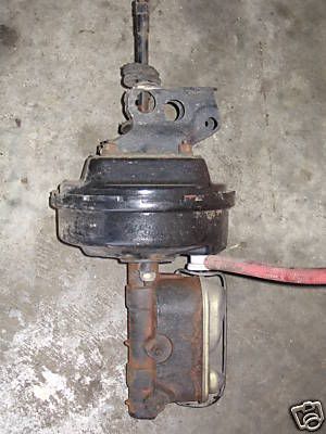

Hi Guys
Would this fit my truck ?? The bloke selling it reckons it's off a 75 model ??
Its just the booster I need, not the Master Cylinder.
I would have a look myself but its being raining for days and I'll get soaked working on my truck.
I am not sure about the bracket ??? Does it look correct ??

Steve,
It is identical to the one on my 67, that came from a 72 model. So it should work. :thup:

The brackets look right, these came off a 68ish bump.

Steve,
Keith's done quite a bit of work on this:
http://www.fordification.com/clutch-brake-brackets.htm
I do remember trying to make one work on my dent I used to have that wouldn't work, (pretty sure there are different strokes on the piston or plunger length). :doh:
