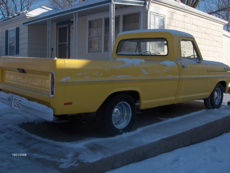

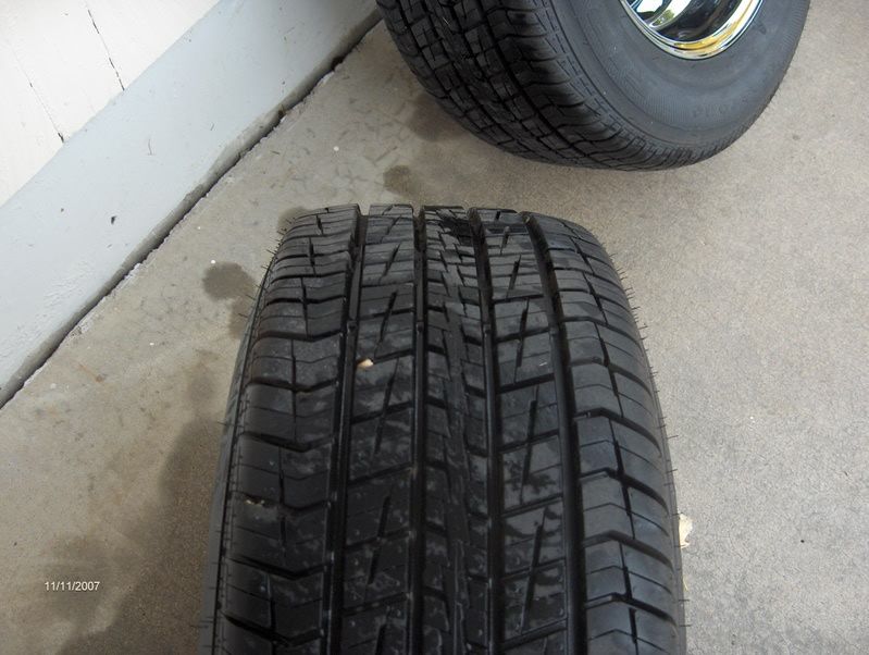

ezernut9mm wrote:i'm running 255/60's on all four corners with 15x8 on the rear and 15x7 on the front. tires are firestone firehawk indy 500's.

Re: re: what kind of tires??
sold the l wheels. i couldn't steer it in a parking lot with all that rubber on the ground. looked cool as hell, but sucked to park. the chromies are american racing and u.s. wheel. thanks for the compliments.F100builder wrote:What's up ezernut? Hey, what happened to the Lightning wheels? The chromies look great. Are they Wheel Vintiques? I still love that yellow with the white grille and bumpers a LOT!
thanks. yes it has cut coils in the front and the shackles flipped in the rear.kilog55 wrote:is your truck lowered? it has a really nice stance to it
