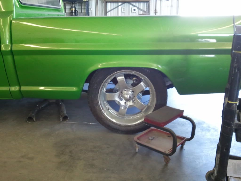

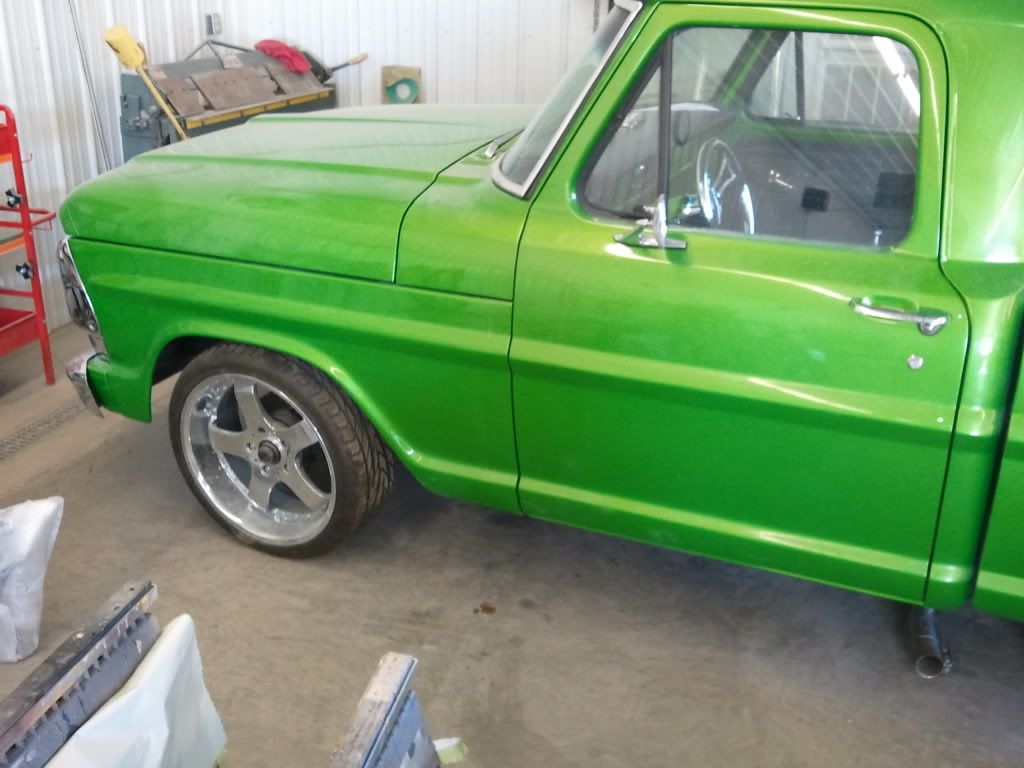

3" beams and 2" coils... pretty simple and rides great
