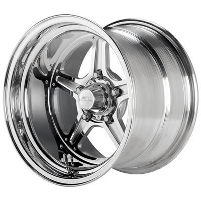

The only thing stopping me from going this route is not being able to run 15" wheels..

not planning on my truck wheels.
I need to change lug pattern to 5 on 4-1/2 as it is because the wheels I want to run only come 5 on 4-1/2 or 4-3/4, and only come 15".
Most important, there what I want.
