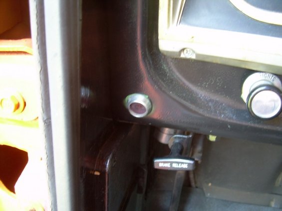

I have a small indicator light on the bottom left side of my dash right above the E-brake release. It says BRAKE in the middle. I cannot find this in my manual ANYWHERE, but I assume that this is an E-brake "Engaged" signal light. Problem is that it does not come on when the Truck is on and the Ebrake is on. And yes - I have checked that the bulb is still good.
Any Ideas?
Any Ideas?

It doesn't come on to indicate E-brake application. It signals when you have a malfunction in one side of your brake system. It's connected to a switch in your brake system distribution block.

Correct. It has nothing at all to do with the e-brake, it's just coincidentally mounted down there.

This is a common misconception about this light. It's not an E-brake indicator. It's a warning light that indicates either your front brakes or back brakes have lost pressure. It's controlled by a brake differential valve. The light should flash on when you start the truck but should otherwise be off. I'd post a photo of the diff valve but we're still hobbled.I assume that this is an E-brake "Engaged" signal light.

You got a broken wire, bad connection or it's unplugged from the switch.
The light should of came on after all the work you've done on the brakes.
When working properly, the light comes on during the prove-out in the "start" position.

yea the light does or is suppose to come on at start up.
