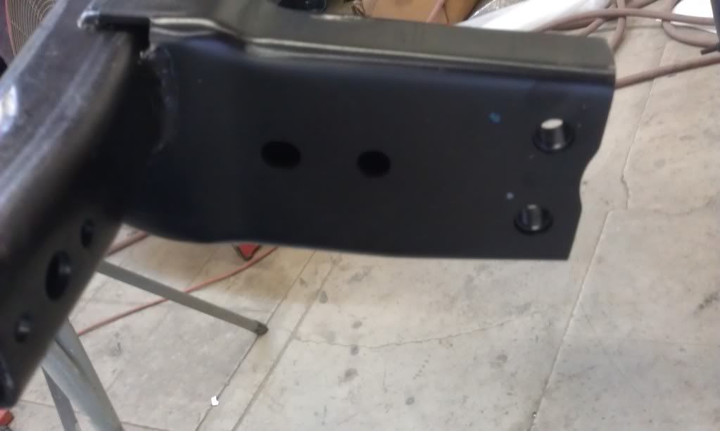

could another shock be installed on that front shock mount.......if you created a lower bracket???????I asked this question on the .net site for dentsides but no response.................I have a set of these same combination shock/coil towers from my 2wd and wanted to replace the separate coil and shock towers on my 4wd ................I know it would be BEST to stagger the shocks but I want to make use of what i already have. somebody please respond

getjad wrote:could another shock be installed on that front shock mount.......if you created a lower bracket???????I asked this question on the .net site for dentsides but no response.................I have a set of these same combination shock/coil towers from my 2wd and wanted to replace the separate coil and shock towers on my 4wd ................I know it would be BEST to stagger the shocks but I want to make use of what i already have. somebody please respond
yes it is possible i am still kicking me for not buying the i beams that were on the truck that i pulled my new cab off of. ford made factory i beams that had the extra front lower mounts on the for the HD frontends

well if you could find the identicle lower bracket as you have already it seems you could just reverse them and blot it up as a sandwich on the I beam. wont work for me because the truck mine is going on is 4wd and not I beam set up. yours looks easy.

the only thing that i can think of is make a template of your lower shock mounts and get them cut out of som high strength steel plates and weld them on
