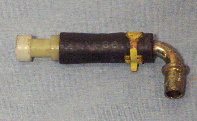

2) that is also your axle vent. The bolt should be hollow. Should have a hose going well out of the way of splash water and muck (frame as yo stated) . (the little rattle type vent caps are the only way to go if you have to replace missing parts).
another generic pic to show the vent "breather" (several types, this is ONE)
As to the vent breathers, I normally just grab a few from the tops of FWD (easier to get to) transmissions while I'm at the junkyard. Pennies and you can get the good ones (metal).

grncustomf100 wrote:1)So the crimped end is actually threaded onto the brass T? I havent yet tried to unscrew that part yet.
2)This line as clogged, even though is goes well above the frame. The axle screw part is clogged as well.
Thanks for the quick reply.
For #2: Unscrew it from the axle. Clean it out with a drill bit or other pointy device, spray it out then reinstall with a new length of hose.
Thats exactly what I did. I also noticed when I initally unscrewed it, that it was under pressure. Hose and vent screw are now both open and clean.
