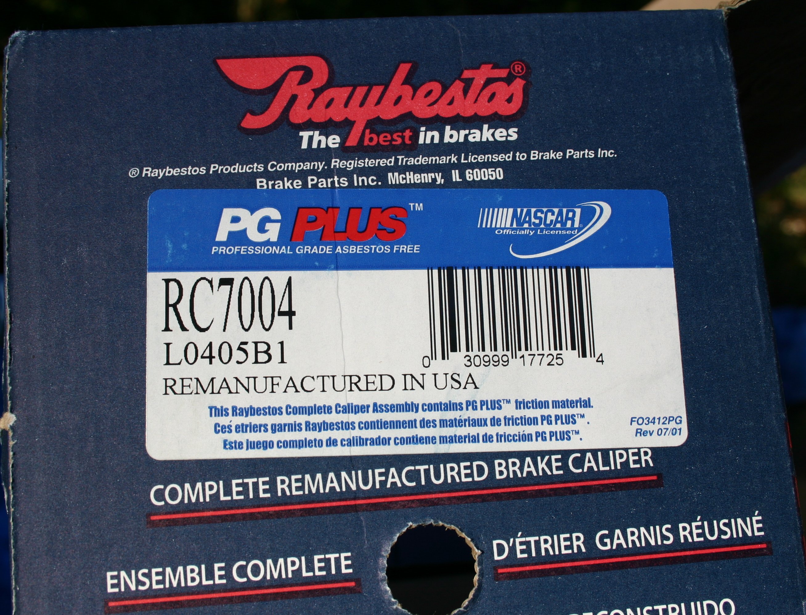

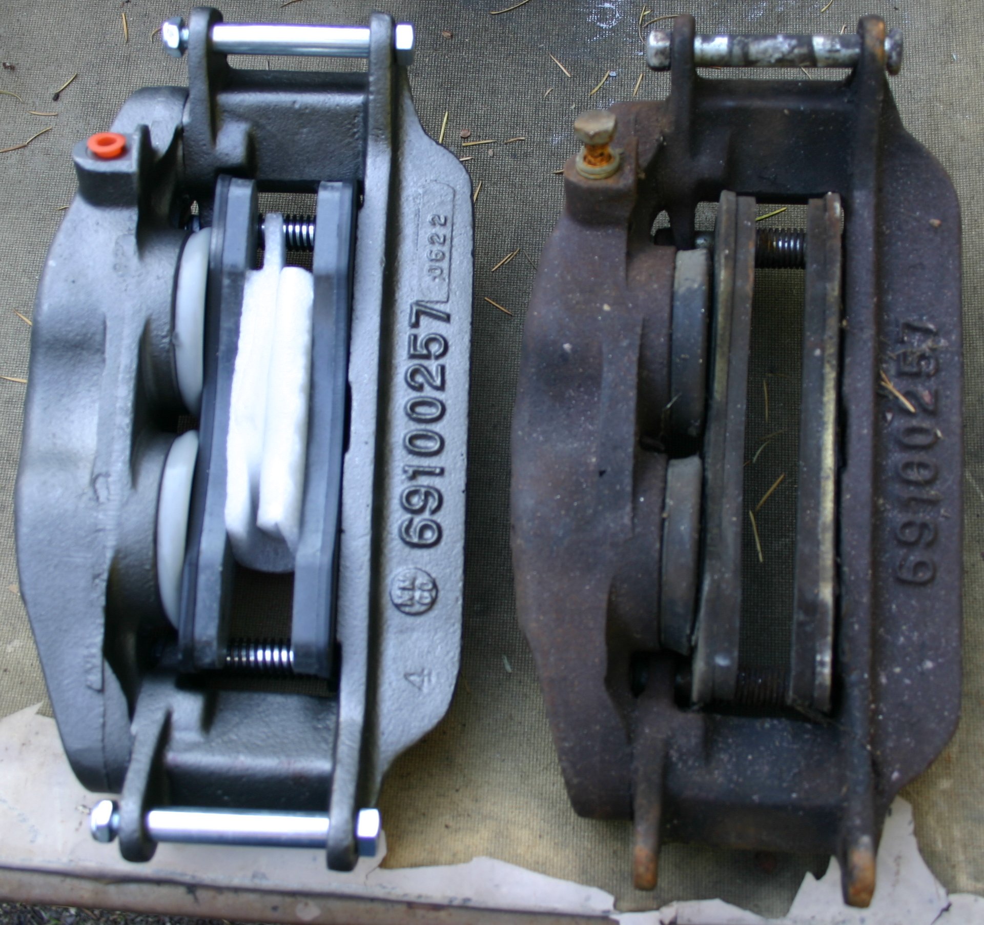

Bill, do you happen to have the boxes that your rebuilt calipers came in, or your receipt? What are their part numbers?
The calipers that were right for my 1972 were the 3/8" ones: Raybestos RC7004.

I don't have the boxes anymore, and the recipt will be a search, but I am almost certain the recipt info. is limited. The calipers have numbers on them and when I was looking at them they are the same. Also your calipes look similar to mine, but keep in mind they are made for your truck which is a higher GVRW and has a beefier front end.
