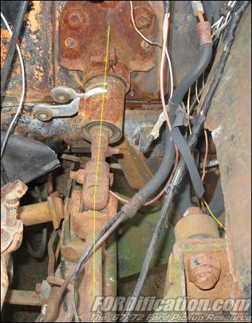

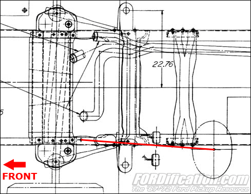

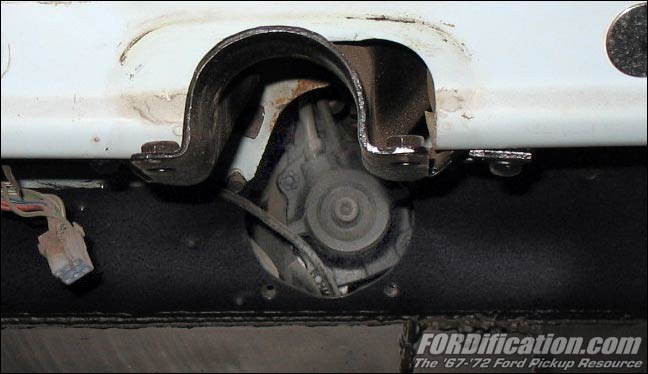

Here's a couple images just for the visual:
This one is taken from the 1970 Body Builder's Layout Book. You can see the relationship between the steering box location and the steering wheel.
In this shot, the camera is on a direct centerline with the steering box's input shaft. You can see how the column would be slightly offset to the left.
And here's one I took of my F100 4x4 parts truck. You can see how the angle exists in these trucks as well.
