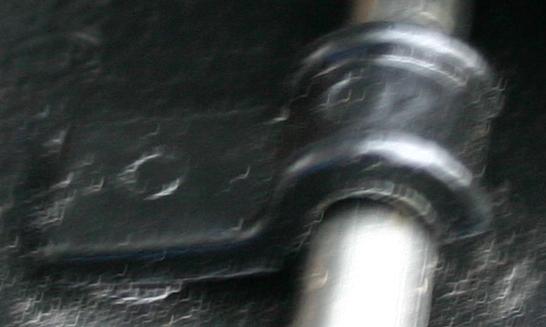

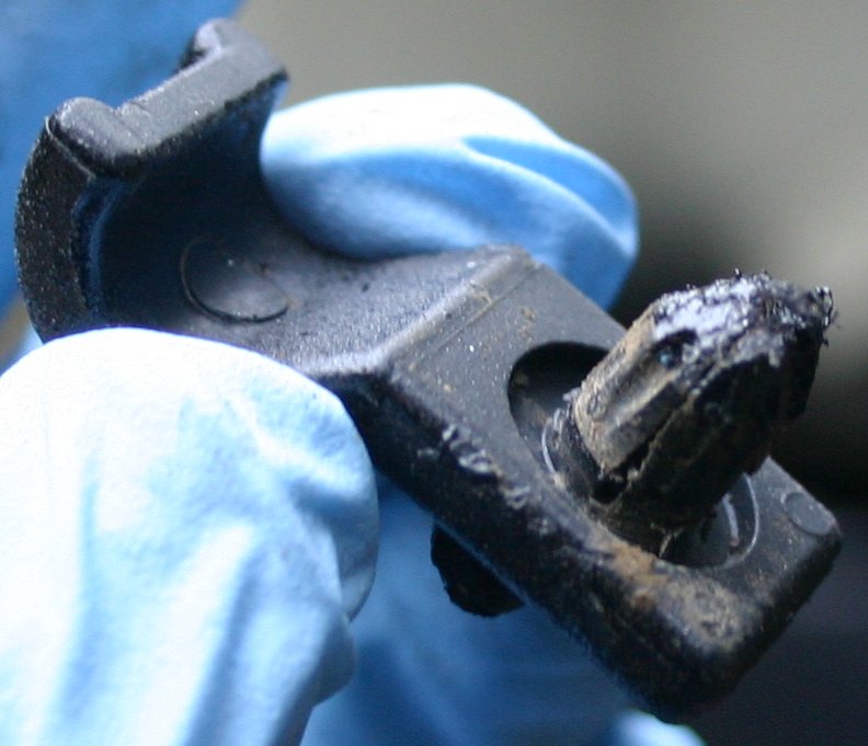

Here are the clips I'm talking about (one off and one installed):
Does anybody know of a source for these clips?
When it comes to the fuel lines especially, I've found that if I bend the clip up enough to get the fuel line under it, the clip stays bent! I can't smash it back down to its natural shape, so it doesn't hold the tubing very snugly against the frame. Same goes with the brake lines although it's less pronounced with those.
Perhaps I'm missing the point--is the proper way of installing tubing under these to bend the clip up, or remove the clip all together? These don't look like they'd take kindly to being removed and reused.

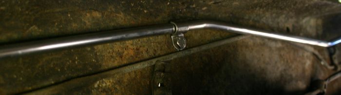

I wound up getting the clips from Inline. In order to use a bolt that fits nicely in the stock frame holes, I needed to drill the clip holes out a little, which was no big deal. Here are some photos of these clips installed; they are WAY more sturdy than the factory clips since they're held on with nuts and bolts instead of plastic arrow heads:
Whoops, no clips in that last photo. I'm just showing off my fancy new stainless tubing!
