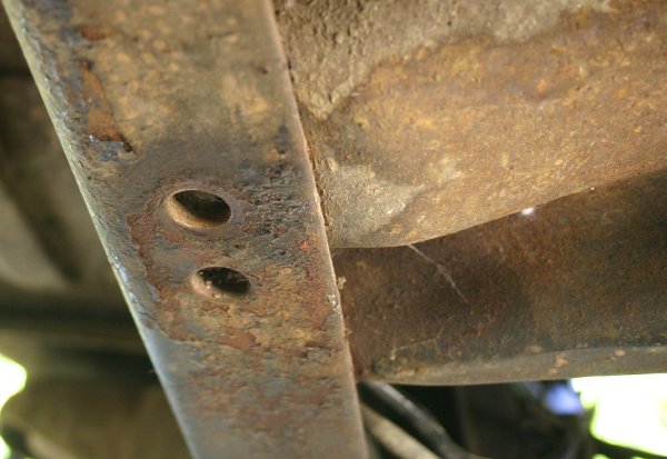

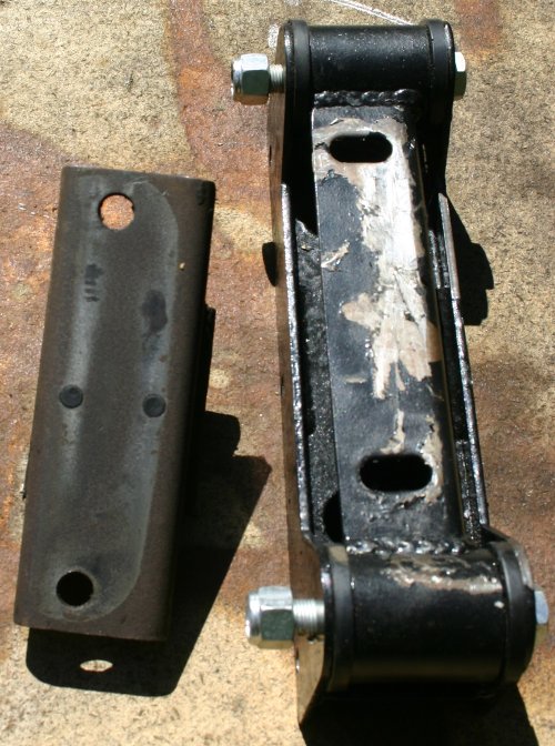

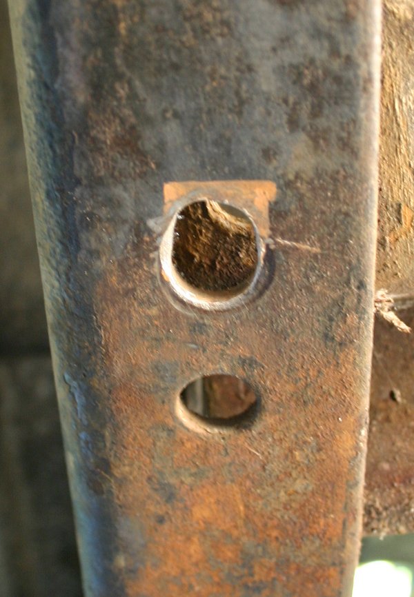

Here's a photo of the Autofab transmission mount up next to the factory mount. Note that the beautiful finish I put on the Autofab mount got pretty scratched up from all the wrestling it took to get it installed and aligned!
The hole closest to the camera is the one that was used by the crossmember that supported the rear of the transmission. Here it is before I elongated it.

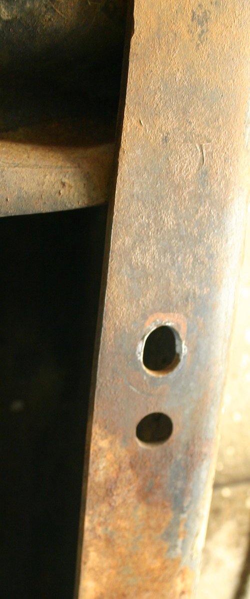

And here it is made a little longer--that's all it took!
Here's the other side, after the same treatment was applied to it.

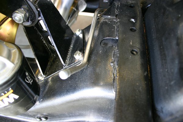

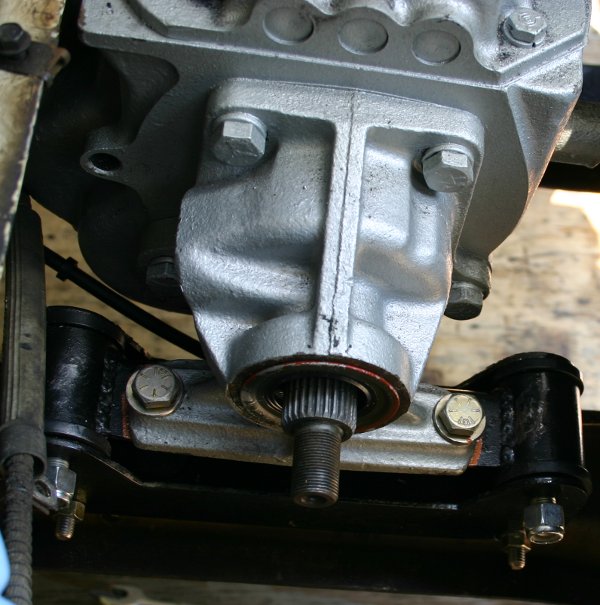

The transmission, all nicely aligned and fastened down.

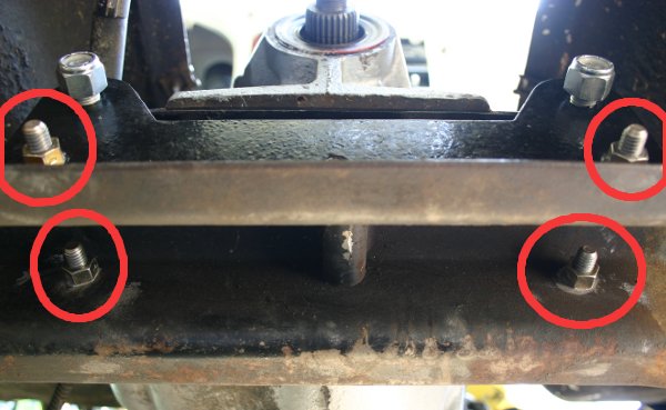

Here are the four holes I drilled in the crossmember after aligning the engine+transmission to the frame. This transmission mount is pretty strong now that it's mounted like this!

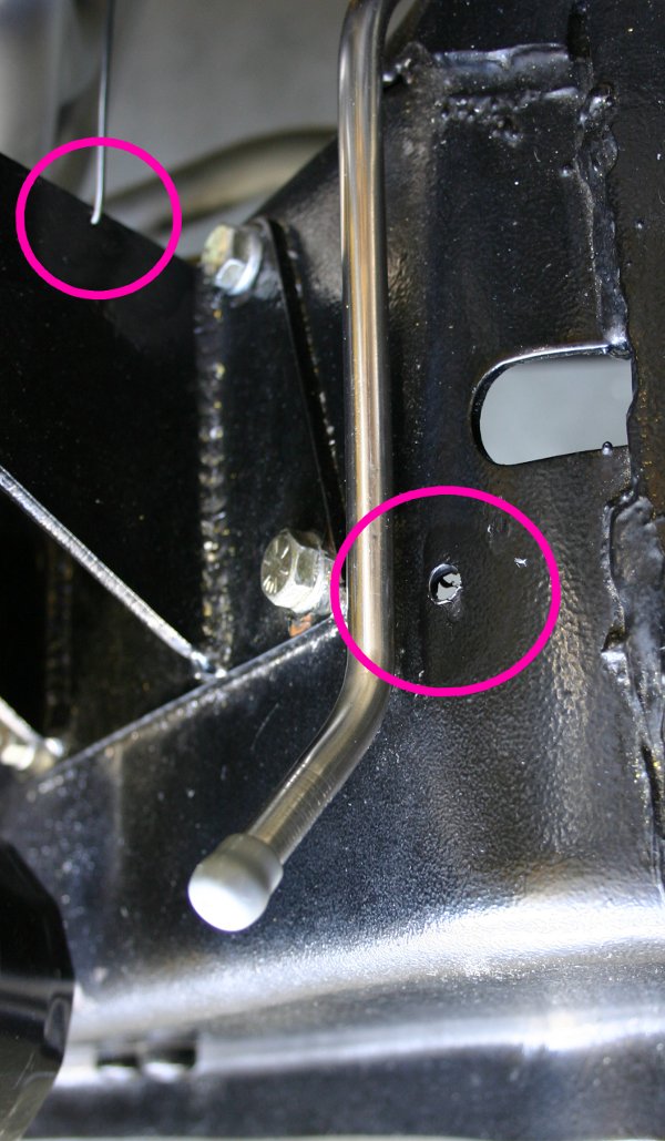

While filling in the details around the engine I've had to do two more customizations to accommodate the Autofab mounts.
The first one involves making a substitute for the factory fuel line clamp. The hole the factory used for this clamp was used by the driver's side Autofab engine stand. So I had to make a new hole and clamp--here are some photos.
This area was problematic without a fuel line clamp there. Not only could the fuel line get to vibrating, but it would yank up if somebody tried to pull a old fuel hose off of it.
I drilled a hole upstream from the fuel line. Also shown in this photo is the tiny hole I drilled in the Autofab engine stand itself to accommodate the clutch return spring (also displaced by the Autofab mount):

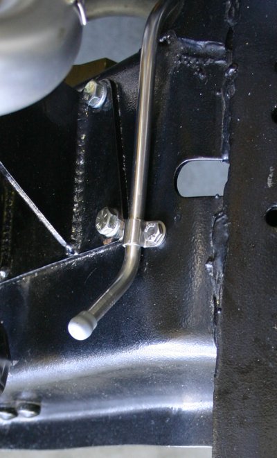

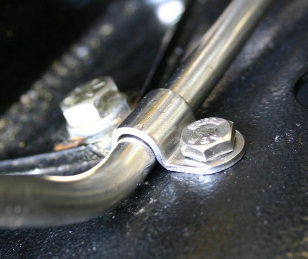

Here's the new fuel line clamp in position:
With the clamp in place, that fuel line ain't going NOWHERE. Yup, it ain't goin' NOWHERE.
