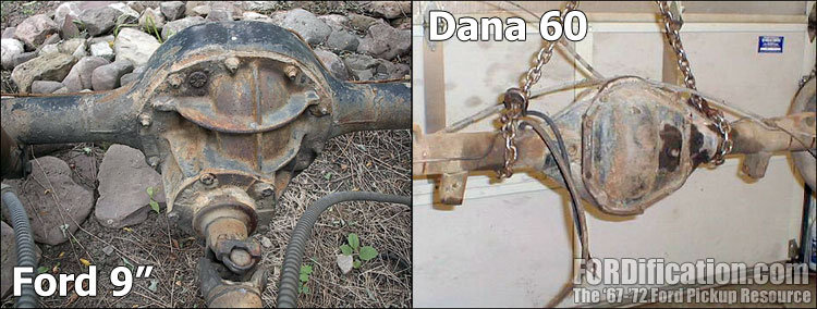

Based on what you're describing, it's sounding like you broke some teeth on pinion and/or ring gear in the rearend....not good at all. Do you have a 9" Ford rearend or a Dana?

it looks like i have the 9" ford rearend.
