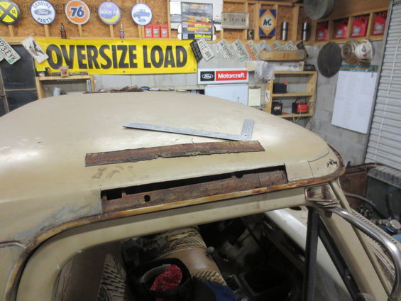

Had odd hours this week but made some progress. Hope to get more done around yard work tomorrow.
Passenger side was not as bad but still rough.

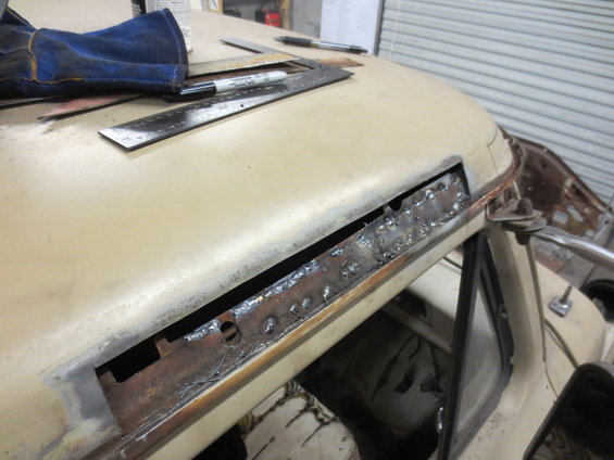

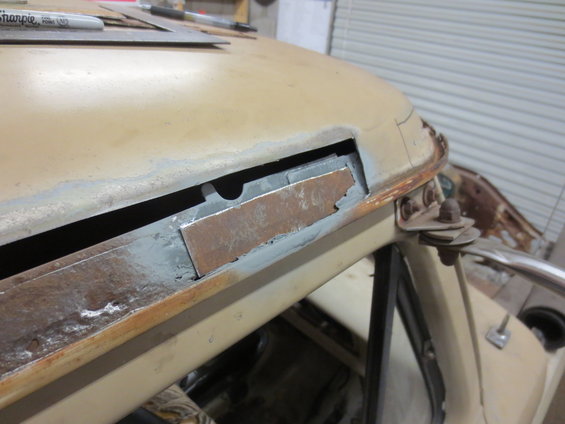

The drip rail was mostly attached but had to add a piece. I've found wedging it in behind the panel then doing top and bottom weld works well.
Also welded up the thin spots in the drip rail and then full welded it down where it was left and ground it all up.
Got the filler patch cut just gotta get it in all for now. :D

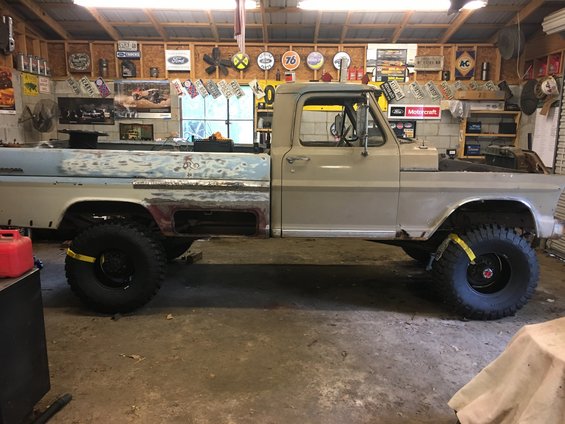

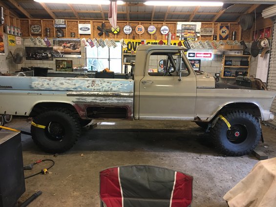

I'll play again. Things that have occurred. 1 78-79 disc brake dana 60 front owned by me. divorced np205 owned by me. So may have to build up that to give better drivability, and more durability. With those components i can also run 1350 1 ton driveshafts everywhere as well.
Secondly i have been messing with stance, and tires. I have some 35' for the 84 bronco. They have been my test pieces. Also thanks to help from Chris on fordification facebook he has a 2 inch skyjacker lift on his. He pulled his measurements, and i was able to apply them in a mockup state. Yep i;m in love.
Hard to take full pictures. 35's stock ride height.
2" lift is going to be a must. Also you notice i finished the passenger side roof repair. :lol:
With that known it opens me up to pull the front clip and get the front frame finished now that stance is settled!!! :woohoo:
