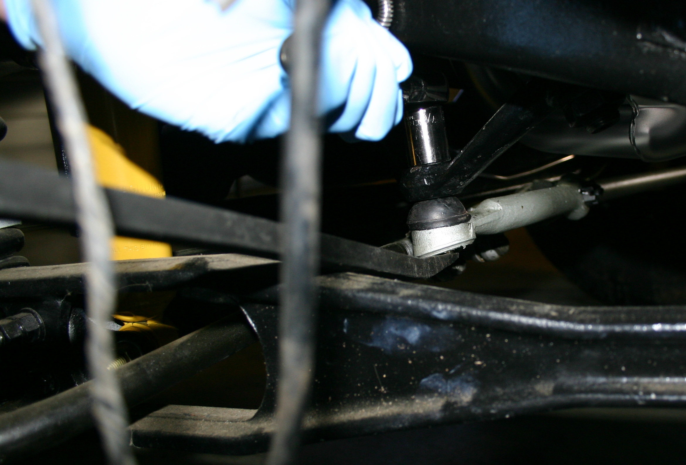

Thanks to the fantastic advice y'all have rendered, this turned out to be far less of a challenge than I thought it might have been. Of course that's partly due to having no front clip, and that makes for easy access to this area!
After pushing the stud up in to the pitman arm and holding it there with a pry-bar, as shown in this photo, I was able to thread the nut on with easy-to-moderate effort. After just a turn or so it smoothed out completely--I probably just had to overcome some minor blemish on the threads, like a microscopic, gold skeleton key or a fly's lunch box.

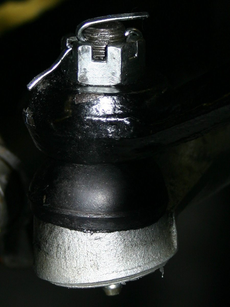

Once I got it started it stayed in one place very nicely! I torqued it to 65 ft/lbs, then turned it ever-so-slightly more to align the cotter pin hole. I enhanced the looks of the poor cotter pin slightly after taking this photo, but needless to say I'm not yet a good cotter pin artist.
