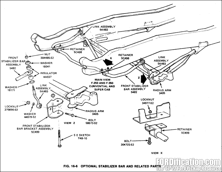

So i finally found a sway-bar off a 79 F250. The problem is i dont see a place for the sway bar links to bolt to on my F100. What do you guys use?

oh i see im missing the bracket.... damn it all....

Re: just a quick sway bar question
you have to have all the brackets in order to use it. here is how they coem off and go back together. http://www.fordification.com/tech/image ... ematic.gif
