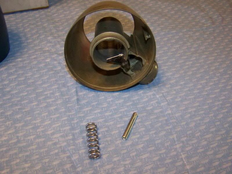

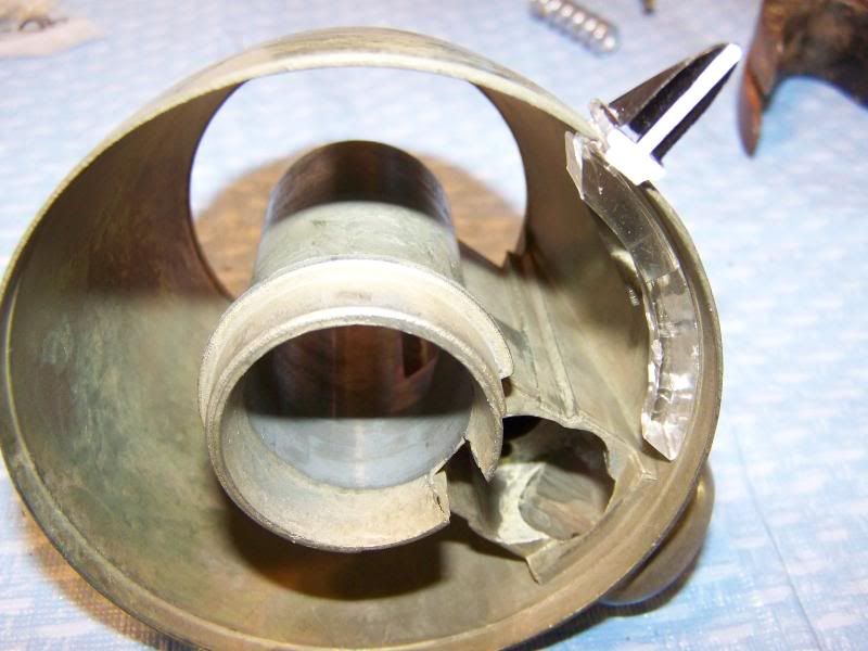

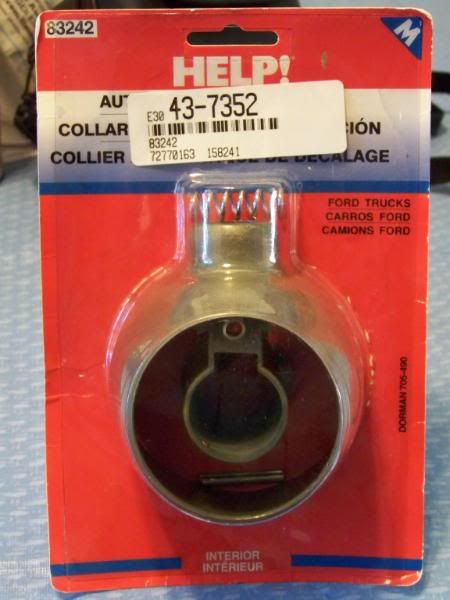

I haven't seen any that look like the originals with the indicator cast in. I am pretty sure all the replacements have a separate piece for the indicator, but I have been wrong before. I did mine with one I think from LMC, it was a Dorman product. Here is what it looked like:
In the package (#83242)

What was in the package (indicator was packaged inside the collar)
How the new indicator looks in place

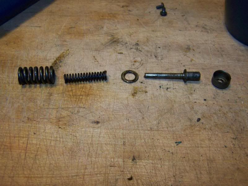

As my springs were still in great shape, I reused them. There were two that fit inside each other on my '72 originally, and the kit only came with one. Here is what the original springs in mine looked like
