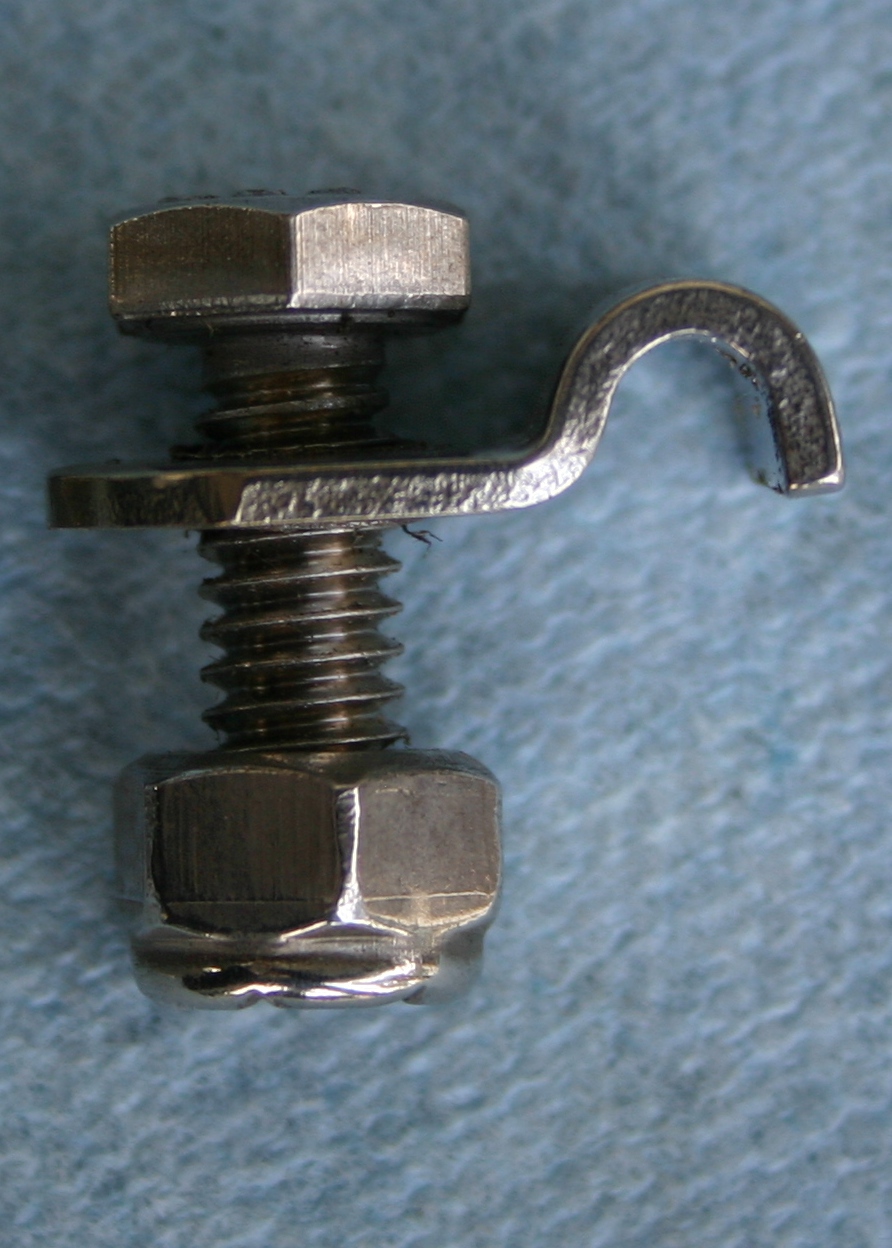

Fordman, the coil spring straps consist of a bolt and small bracket that is basically a larger version of this correct? It located at the very top of the spring?
http://www.robroygregg.com/Number50a/IMG_9548x.JPG
BTW I think that is a great idea taking it out in one large so I can work on further disassembly with much easier access to everything. Thanks!!!!

the coil spring strap has two nuts tach welded to it and two botls got through it. it does have a curve in the middle where the coil sprign sits under it. i couldnt find my pictures of them.
