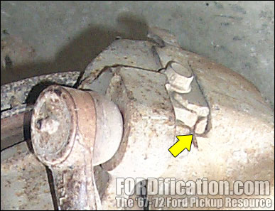

re: Disc Brake -- Seperating Rotor from Spindle from Caliper
You can bang away all day long with a BFH and it ain't goin' anywhere. What you need to do is tap out a long spring keeper, from the backside out:
looking at the picture helps alot.
I just need to wedge a screwdriver into that spot and pry it outward?
I don't think I have that completely right....but I'm not able to look at mine to recall specifically. However, the yellow arrow in the picture above is actually pointing to the flat spring. IIRC it's the flat piece of steel immediately above the spring that needs to be removed. It's just a wedge and need to be tapped out from the backside to the front. Once removed, that will allow the caliper to tip forward and slide out. Don't pry anything and don't start whacking on the spring...tap out that wedge on top.
Thanks Keith, I reread your post as well and figured you meant to slide a screwdriver inside the caliper and punch the tab out from the inside.
I will give that a shot and if all goes well will repeat on other caliper.
