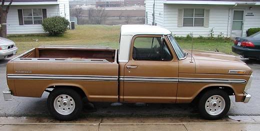

Hey Keith
Do yo have any pics of (chris's)Cobraf100's truck,prior to the work he has had done . I think it appears above the did you know at the top of the page a couple of times. If memory serves me that truck was bought new by Chris's grandfather and started it's life as as a LWB. and was shortened by his grandfather in the drive way.
Awe found it. (nice wheels look just like mine, wait they are)
