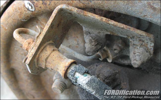

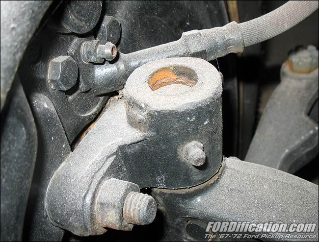

Here are a couple of extra pictures, just for the visual.
Here's the style that threads directly into the brake cylinder:
...and here's the style with the mounting bracket and hard line:
I actually kinda doubt the local parts store is going to have that hard line and bracket...but then again I've been surprised at times at what's been available. It certainly doesn't hurt to ask. You might just have to get those items from a junkyard truck or post something in the Parts Wanted section here, and I'm sure someone could get those from their parts trucks.
