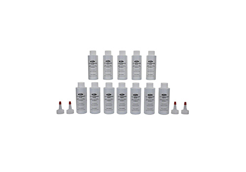

Be sure to get a 4-oz bottle of friction modifier to protect your LSD clutches. However, assuming the previous owner also had the friction modifier in fluid, you should probably only use about half the bottle, not the whole thing. That'll make things a bit too slippery for the clutches to properly grab. My advice would be to go with an additive-free oil like NS(non-limited-slip)-type and add just enough of the additive to get rid of any chatter in turns.
http://www.fordracingparts.com/parts/pa ... Field=6930
